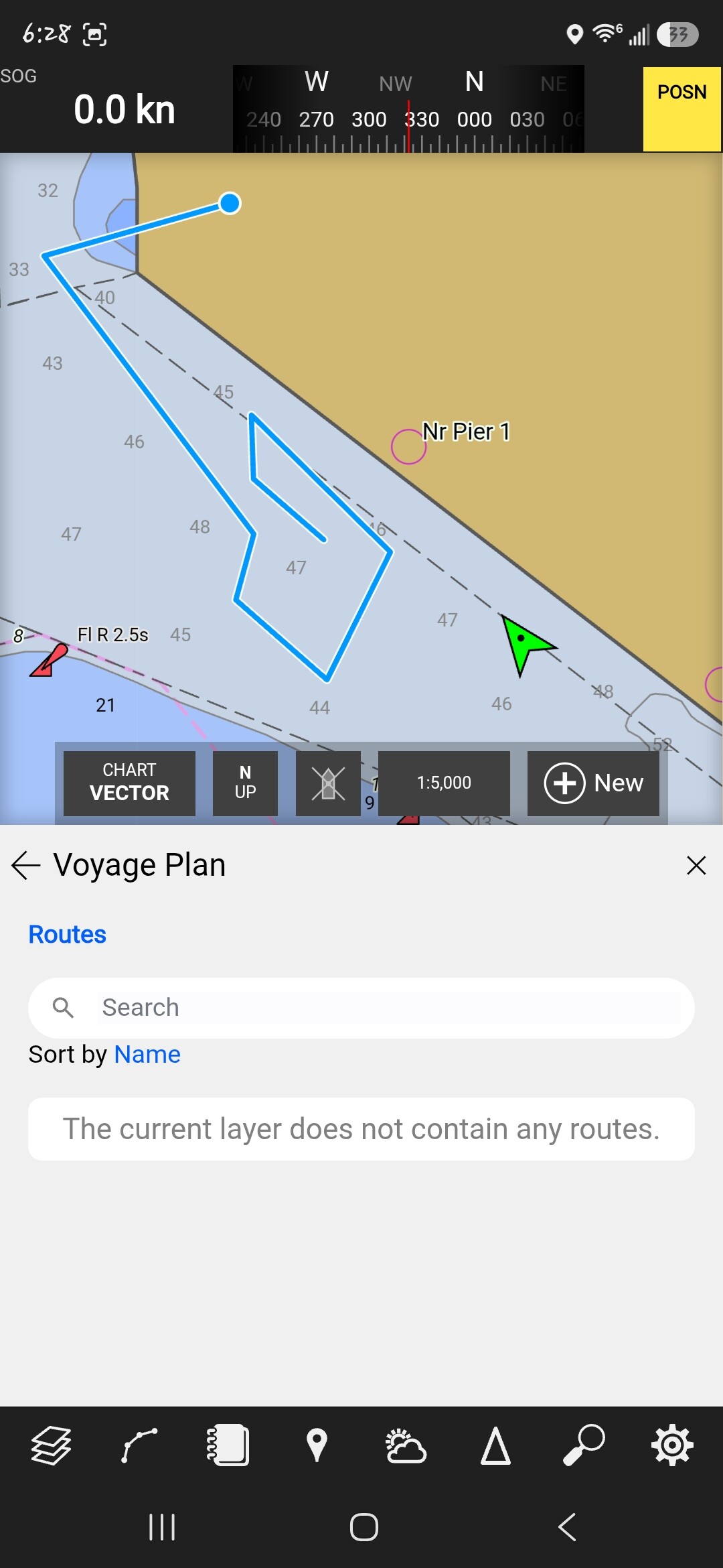

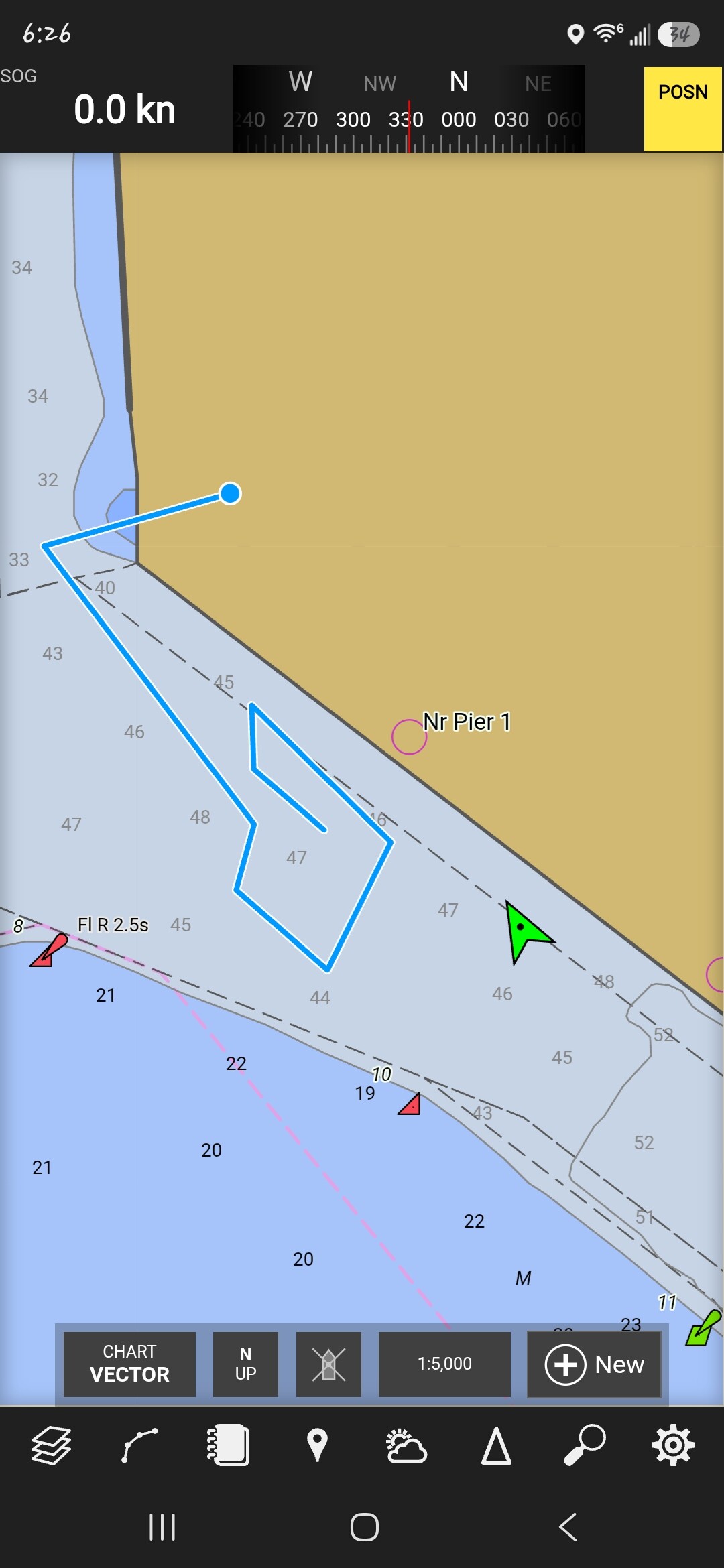

I have done that as well. Created a 72 mile route from Jones Inlet Long Island to Shelter Island NY and when I got to the end I double clicked on the last waypoint or what should be the last waypoint and the entire thing just disapears. I will try and send a picture of what it looks like.
There is a barely visible “Log” button on the far-right side of the part of the Settings screen that has the “Update Now” and “Options” buttons. Try tapping that, Using the Copy option, and then pasting that into an email to support@rosepoint.com and we can try to figure out what’s going wrong.
See thats the best I can post of what it looks like what’s happening mind you it is happening on the iPad and the Galaxy phone I have. So I am thinking it is an account thing I am not too sure. It does not do this on the laptop using the Rose Point version.
