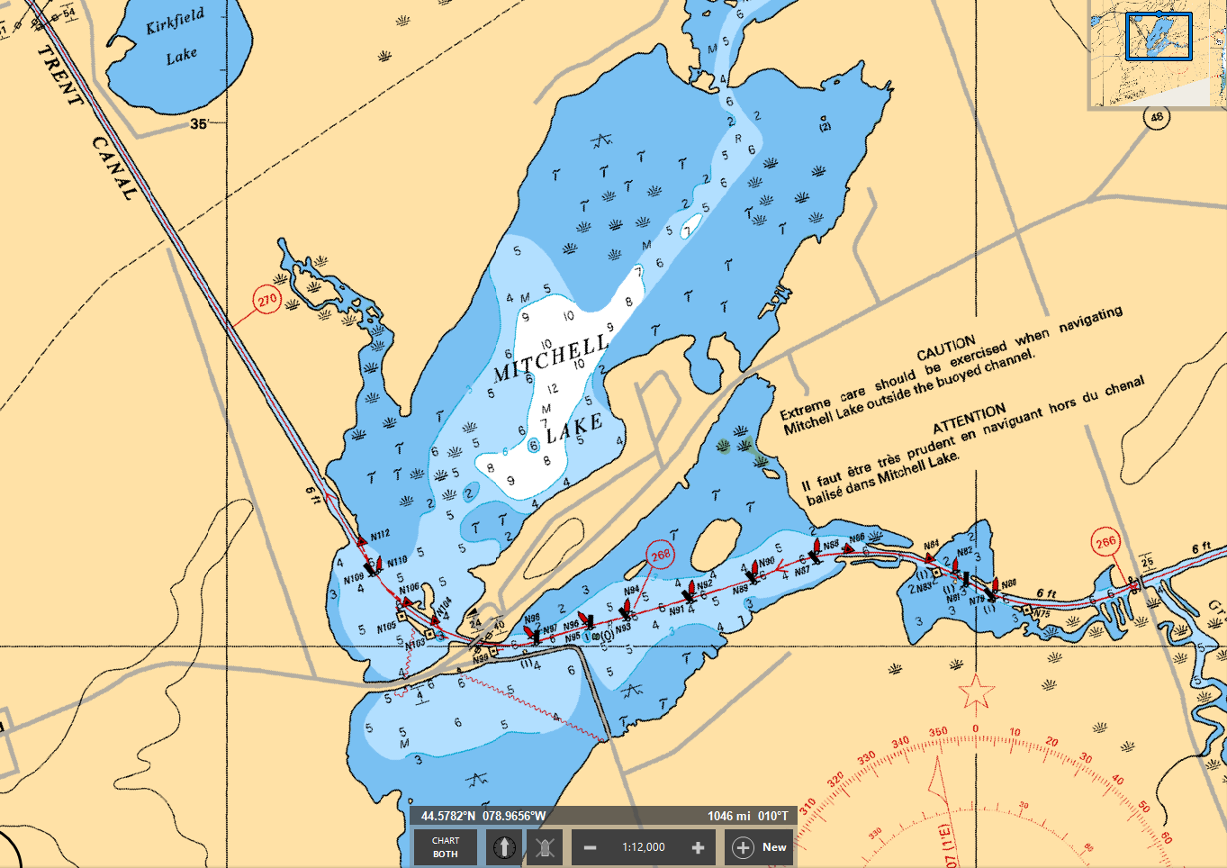

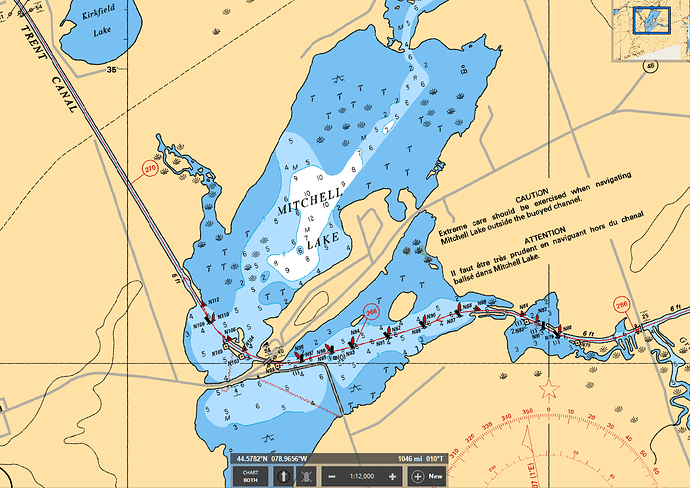

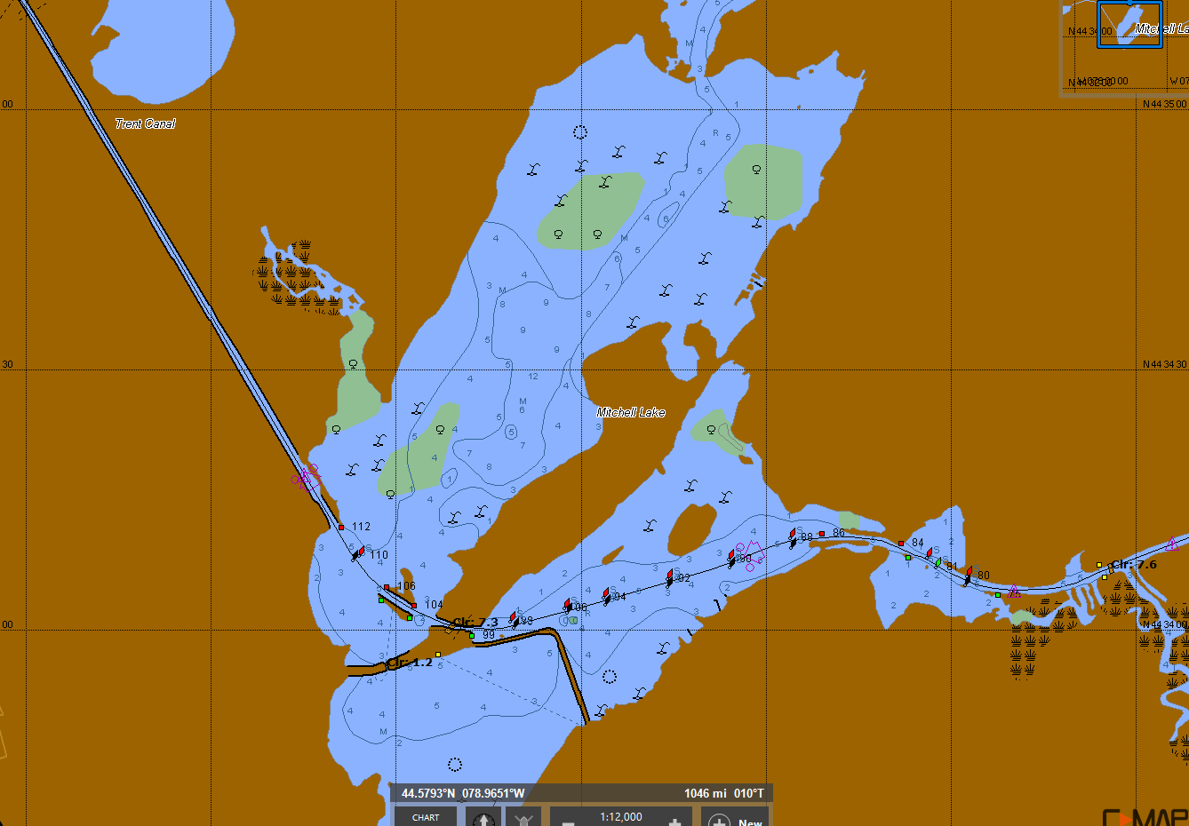

Here’s a comparison of the Canada Hydrographic Services raster chart and the C-Map chart for Mitchell Lake on the Trent-Severn. I think the C-Map charts are still available through the Coastal Explorer chart store link.
Thank you. Last I tried CMAP wasn’t working. I see it is now.
