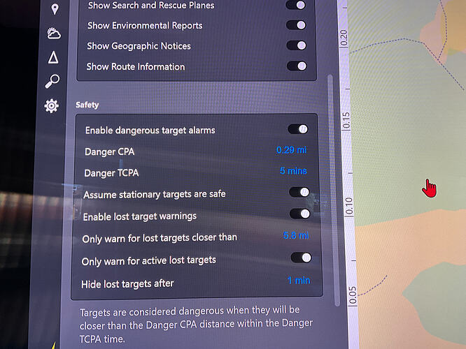

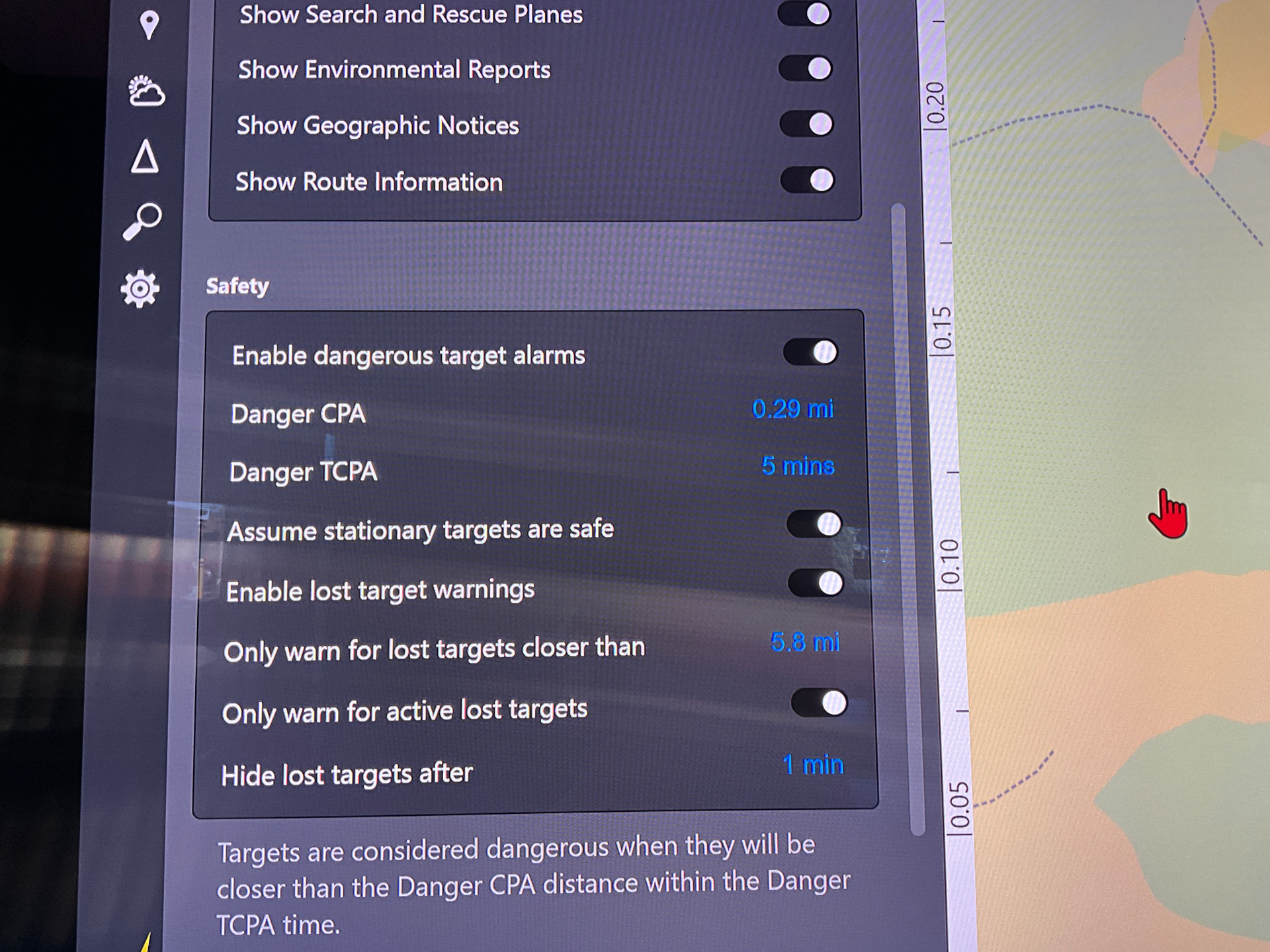

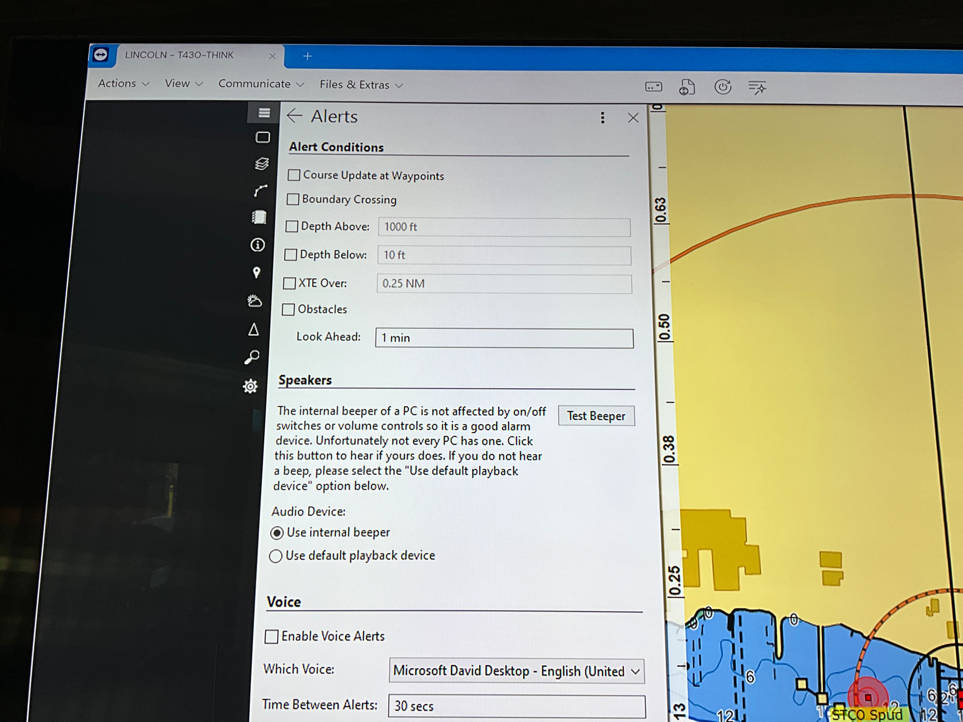

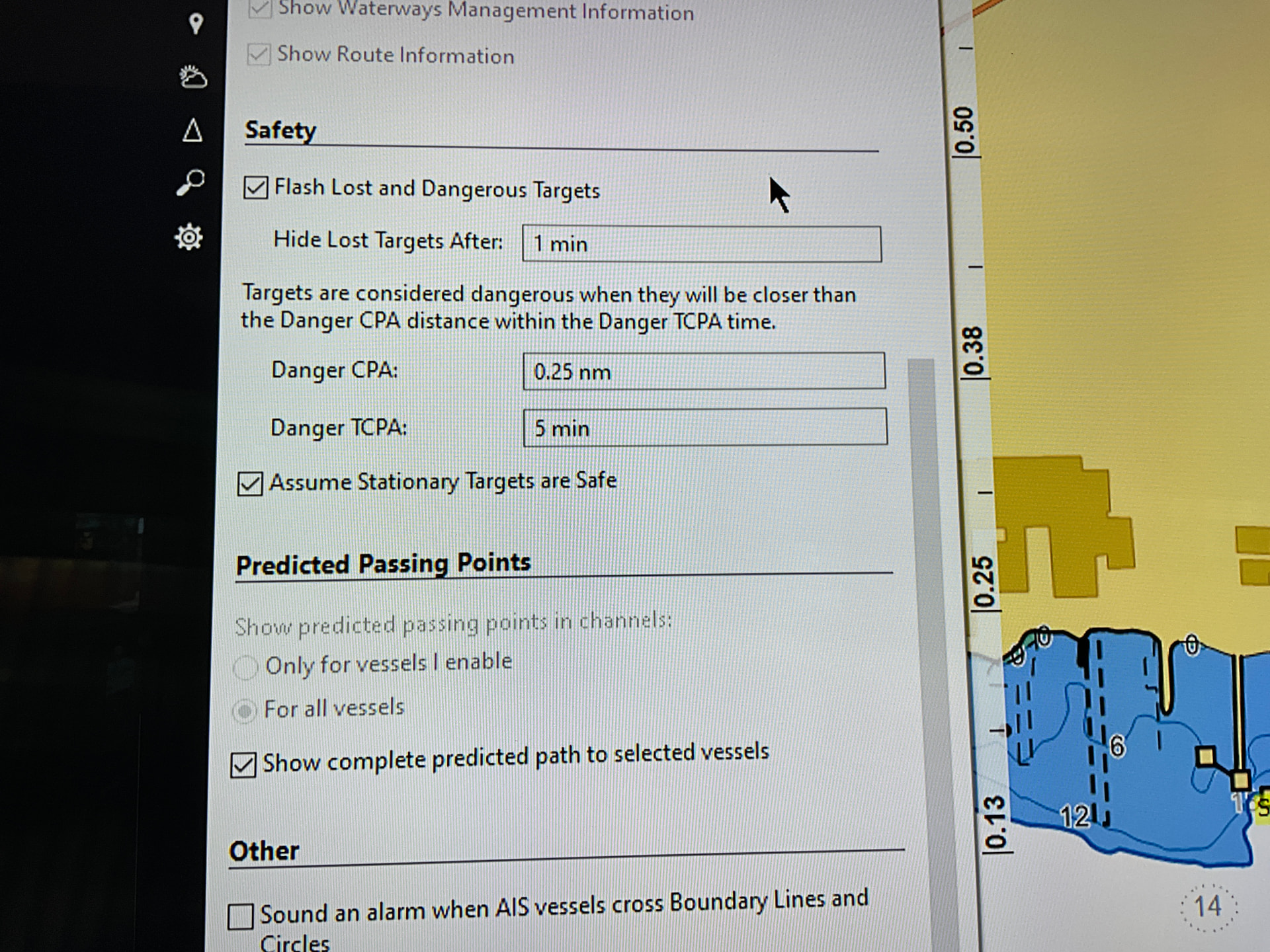

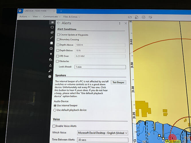

In version 4.0 it only would flash dangerous targets without an audible alarm that I knew of and had another captain ask me about it. I might have missed something but could not find how to turn on an audible alert. Now I see in the update that it lives in the AIS menu under dangerous target alarms but does not say if it is audible. It just might be operator error on my part.:thinking:
I see you (like many/most) have Voice Alerts disabled… If that was enabled, it would announce “Possible collision with in minutes” when a target becomes dangerous. However, in v4, when voice alerts are disabled the system should emit a notification sound instead. In v4.5 we’ve added a more “persistent” alarm that will sound until it’s acknowledged.
One problem we’ve run into with audio alerts is that users have complete control over the volume and tend to turn it all the way down when something is annoying. This is why v4 offers the option to use the “internal beeper” which cannot be adjusted. Unfortunately most PCs made these days don’t have one and there’s no way for software to know (which is why it has the Test Beeper option).
With “Use internal beeper” enabled on a system that doesn’t have a beeper, most alarms will not sound. However, the sound that is played when a voice alert would be made if it were enabled will always use the default playback device to play the standard system notification sound.

In v4.5, the passing point predictors now work across confluences (making the assumption that both vessels will take the shortest path to the other). While this isn’t the same as finding another vessel’s ETA at a certain spot, it will help decide who will get there first. But we might be able to make clicking along the PPP show when the vessel will get to that point…would that be adequate? (It would only let you find ETA’s between the vessel’s current location and the point of passing, but it seems like that’s all you would need.)
Oh yes, that sounds like it would work great. Was there any progress on the wonky PPPs jumping rivers and being way off when overtaking?
No progress yet, but we’ll be sure to get it fixed before the beta ends!
