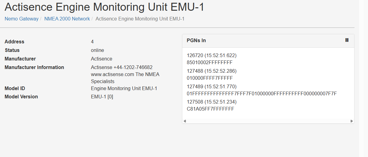

I can’t seem to get CE to use the data from the EMU-1 in either version of the RPM gauges (text or analog) . It’s definitely showing the device and the NEMO web interface shows it’s receiving the data. Cycled everything multiple times. Factory reset NEMO. Its getting other data from the NEMO
What are you supposed to enter in the source box? I tried [004], 004, 4, EMU-1 [0] and a couple other things.
Based on your screen shot, you should enter engine-1 in the source box of the instrument. The 1 is the NMEA 2000 device “instance” number, and normally engine instance numbers start at 0, so if you two engines and want an instrument for each of them, the other one would be engine-0.
