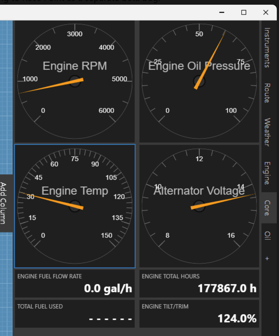

I have the Setup>Measurements set to Fahrenheit, but the Engine Temp is in Degrees C despite that:
Note: The Engine Tilt/Trim is locked at 124 – That is correct according to the N2K data from Actisense’s Reader – it mean “unsupported” – this Is NOT a C.E. bug.
We’ve fixed the temperature conversion problem for the next update.
