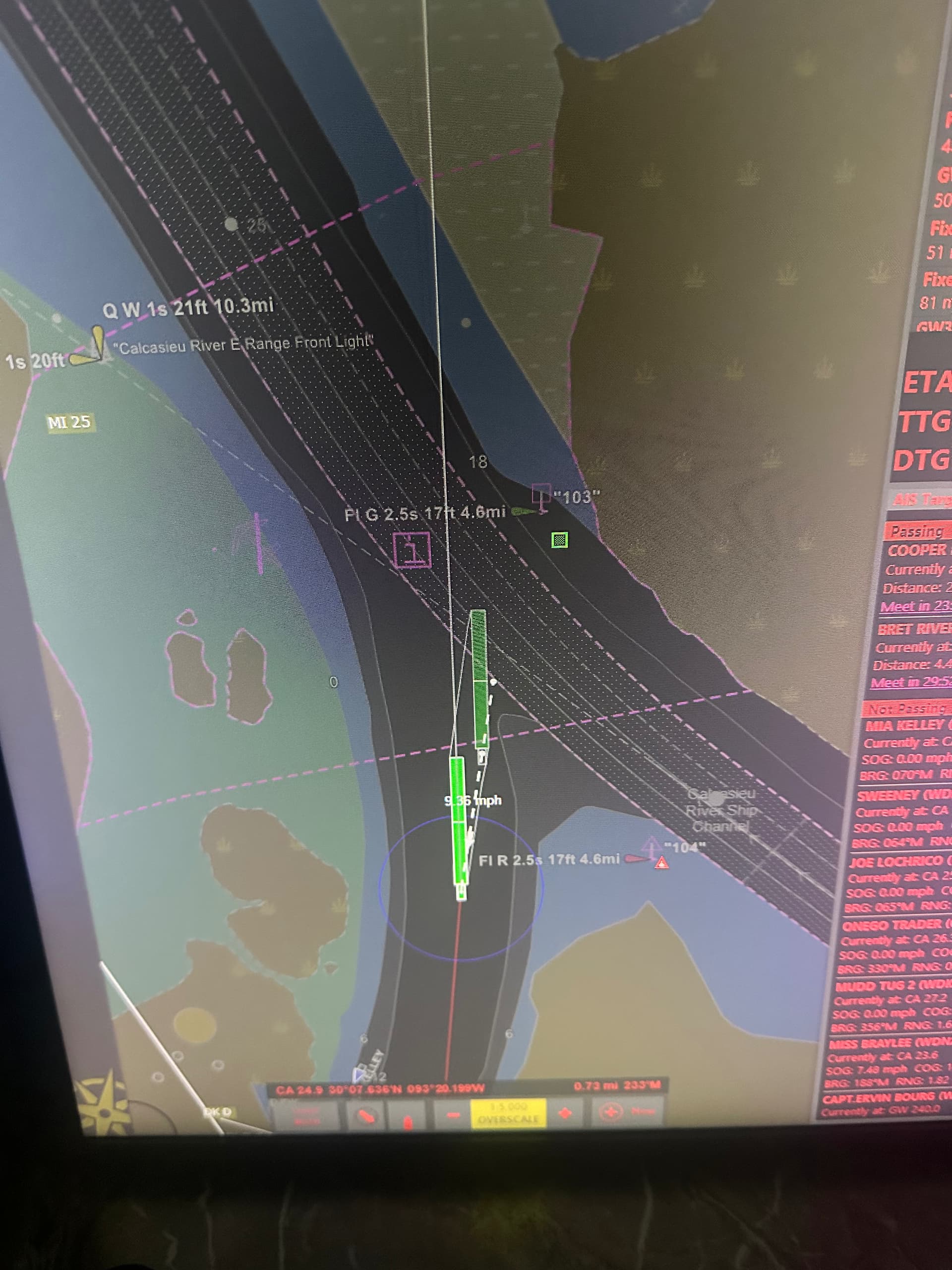

My ghost ship predictor is not working correctly. It only shows a slide until I turn harder than 3°. How can I get it to show the curve predictor line?
My first thought is to double check that the ROT is turned on in own ship properties. It also might be the Satellite Compass needs a reboot. Good luck :+1:
