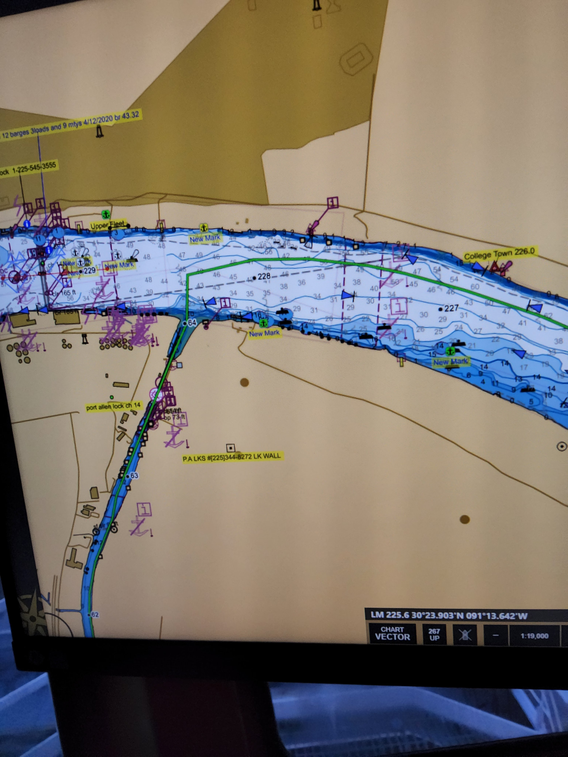

CPA while overtaking a vessel on the Mississippi is giving wildly inaccurate predicted passing points. Also below Baton Rouge, overtaking predicted passing point will jump rivers from Mississippi to PAR instead of showing passing point on Lower Mississippi.

CPA time in overtaking situations has consistently been very inaccurate and does seem to default to changing rivers (on Lower Mississippi at least) as observed below. Meeting CPA times are spot on.

Predicted passing points: I’ve added this to our issues list and will look for a way to replicate the problem. Do you happen to have a voyage recording that shows these issues?

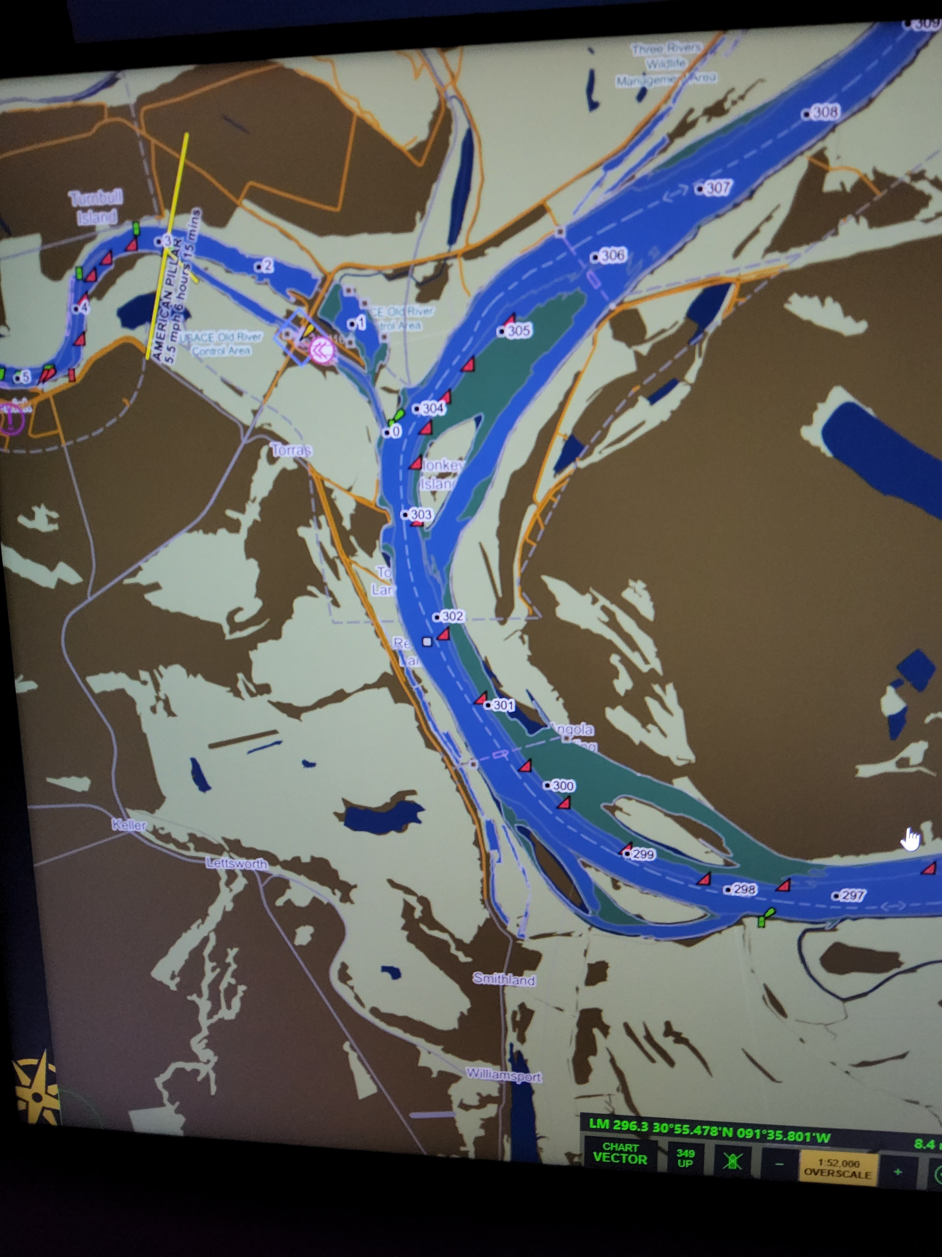

Unfortunately it doesn’t look like my voyage recorder is set up, I do have another screen grab of the predicted passing point issue from somewhere else.

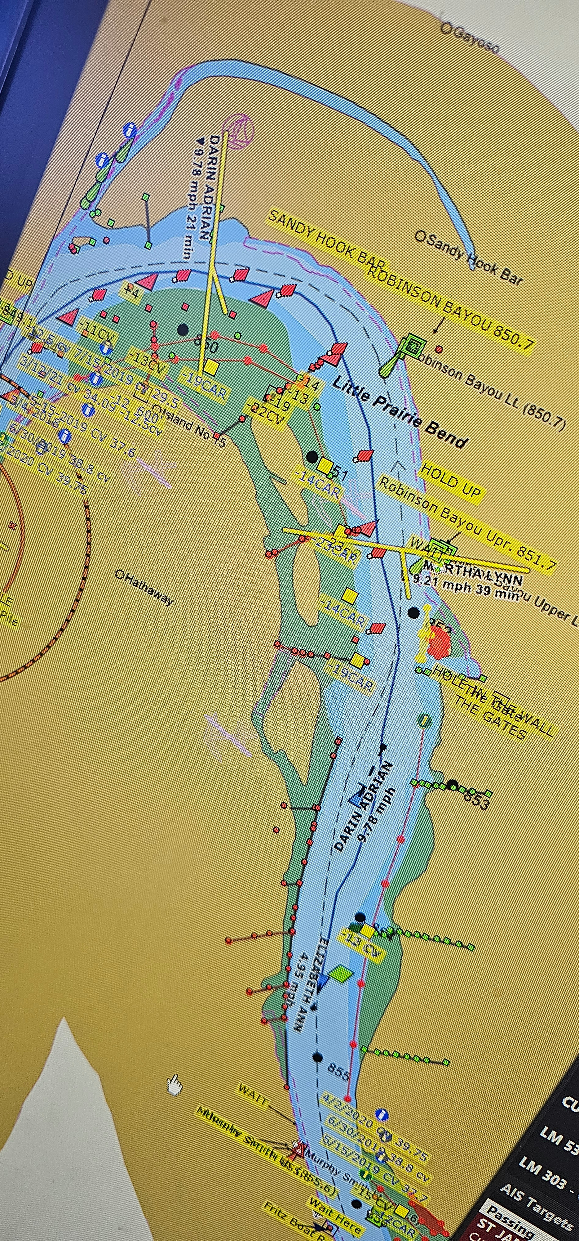

Not a great picture but the green line is the predicted passing line heading from LMR in the PAR. I was maybe 5 miles below area shown overtaking a vessel.

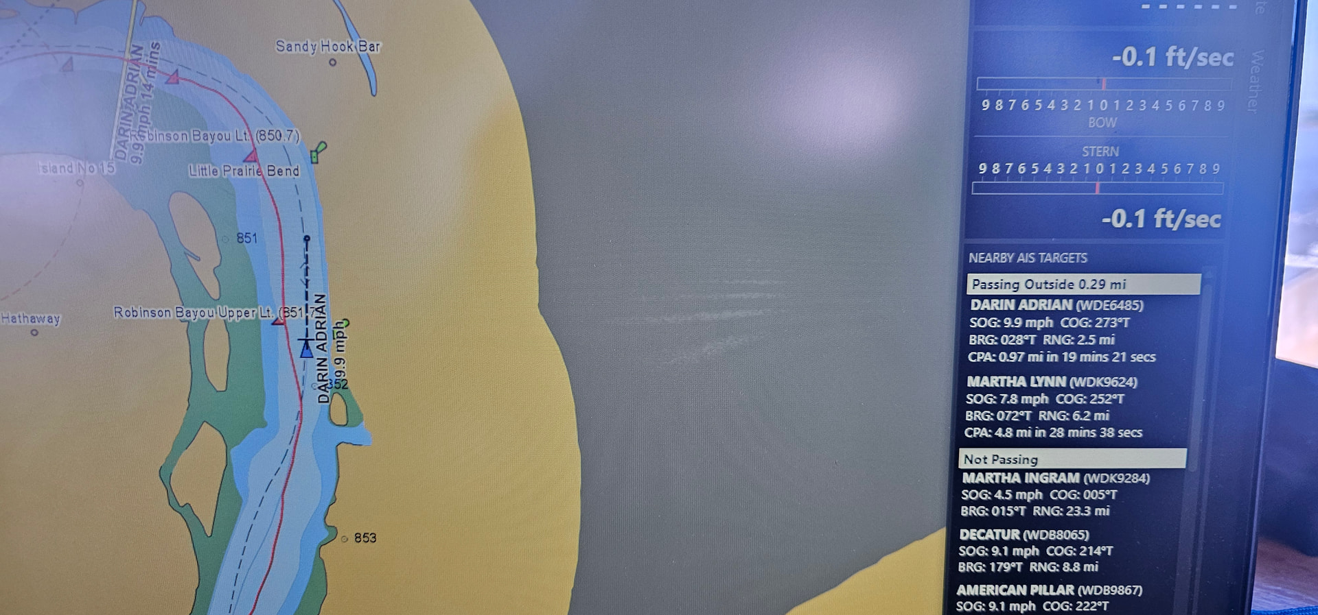

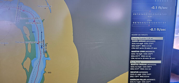

I’ve noticed a couple times some meeting points fail to show up. It seems to be related to the relative courses of the meeting vessels; because of the shape of the river,
a boat that I’ll be meeting may have a heading “behind” me as the crow flies. In this example the Martha Lynn shows a CPA of over 4 miles, which seems about right if he was going to stay his course straight over land.

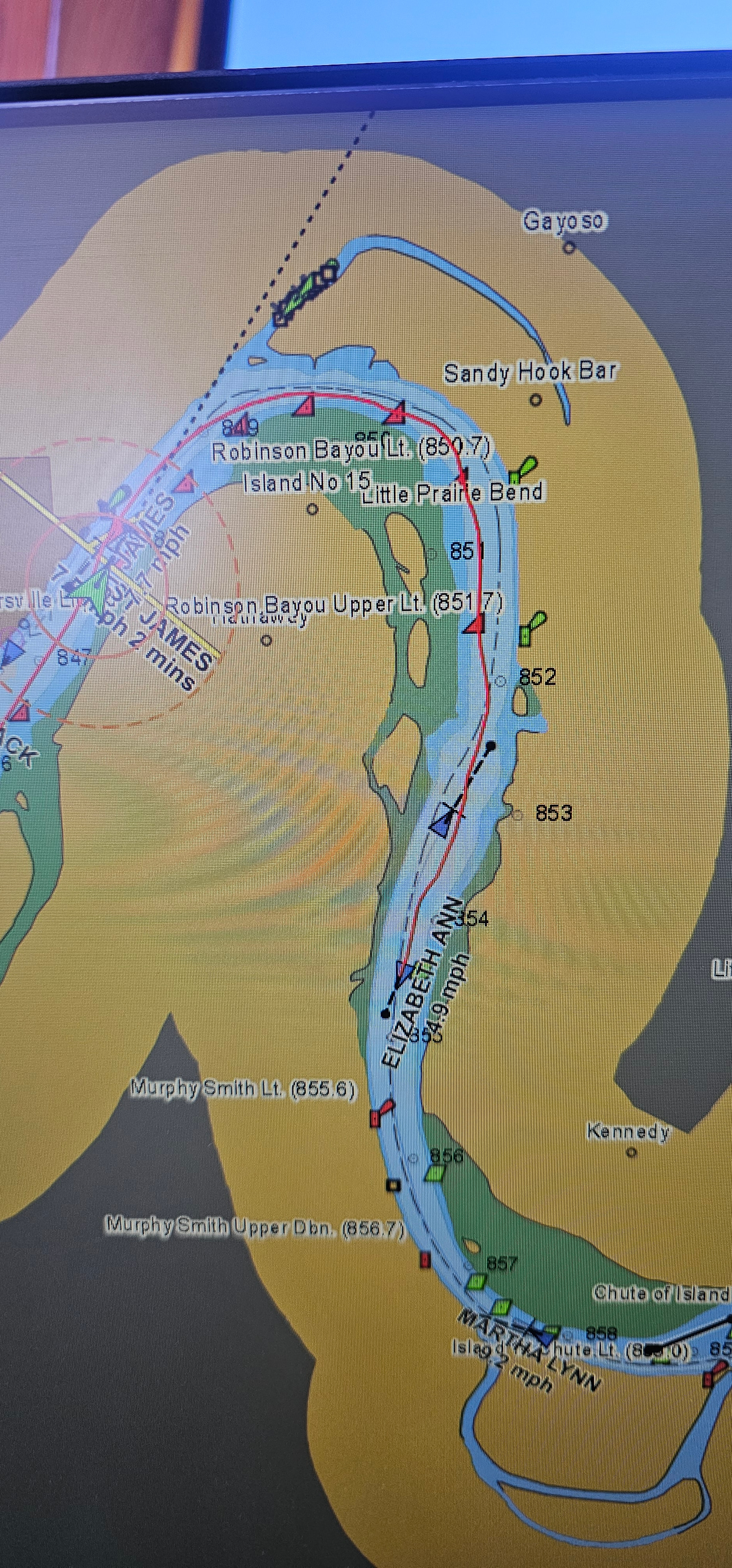

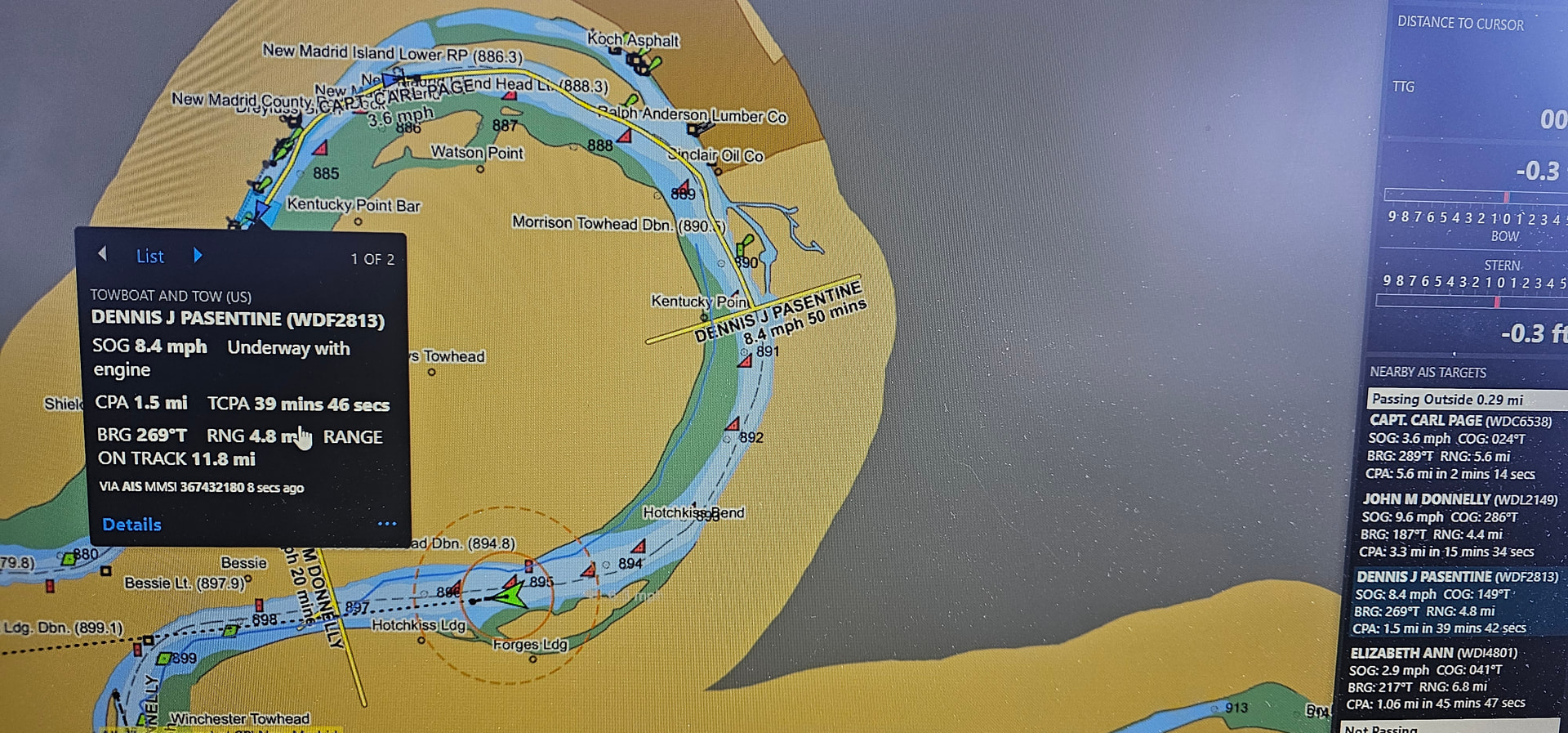

I found another example of a weird predicted passing point that popped up after we had met a boat traveling the opposite direction but because of a horseshoe in the river our headings crossed again, which resulted in a CPA line appearing behind both of us.
