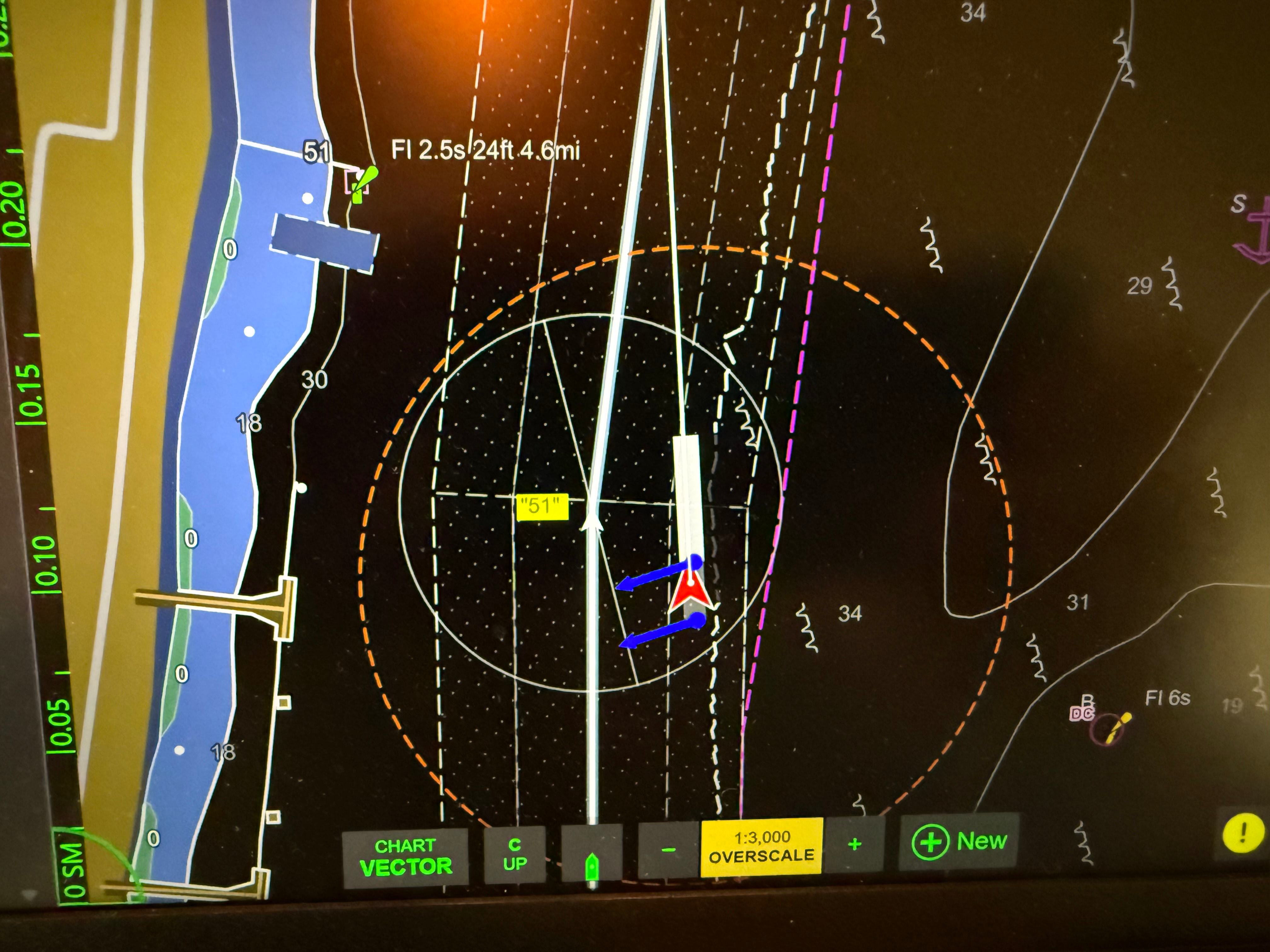

High contrast not working well with barge editor

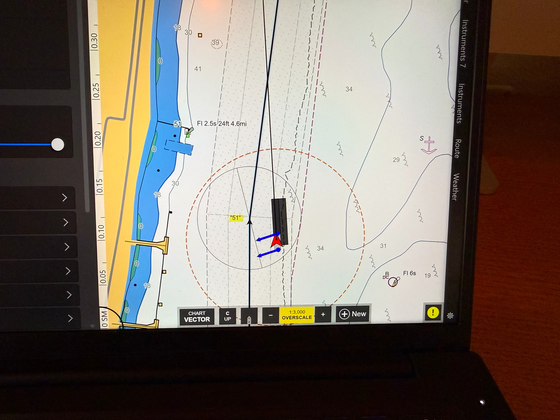

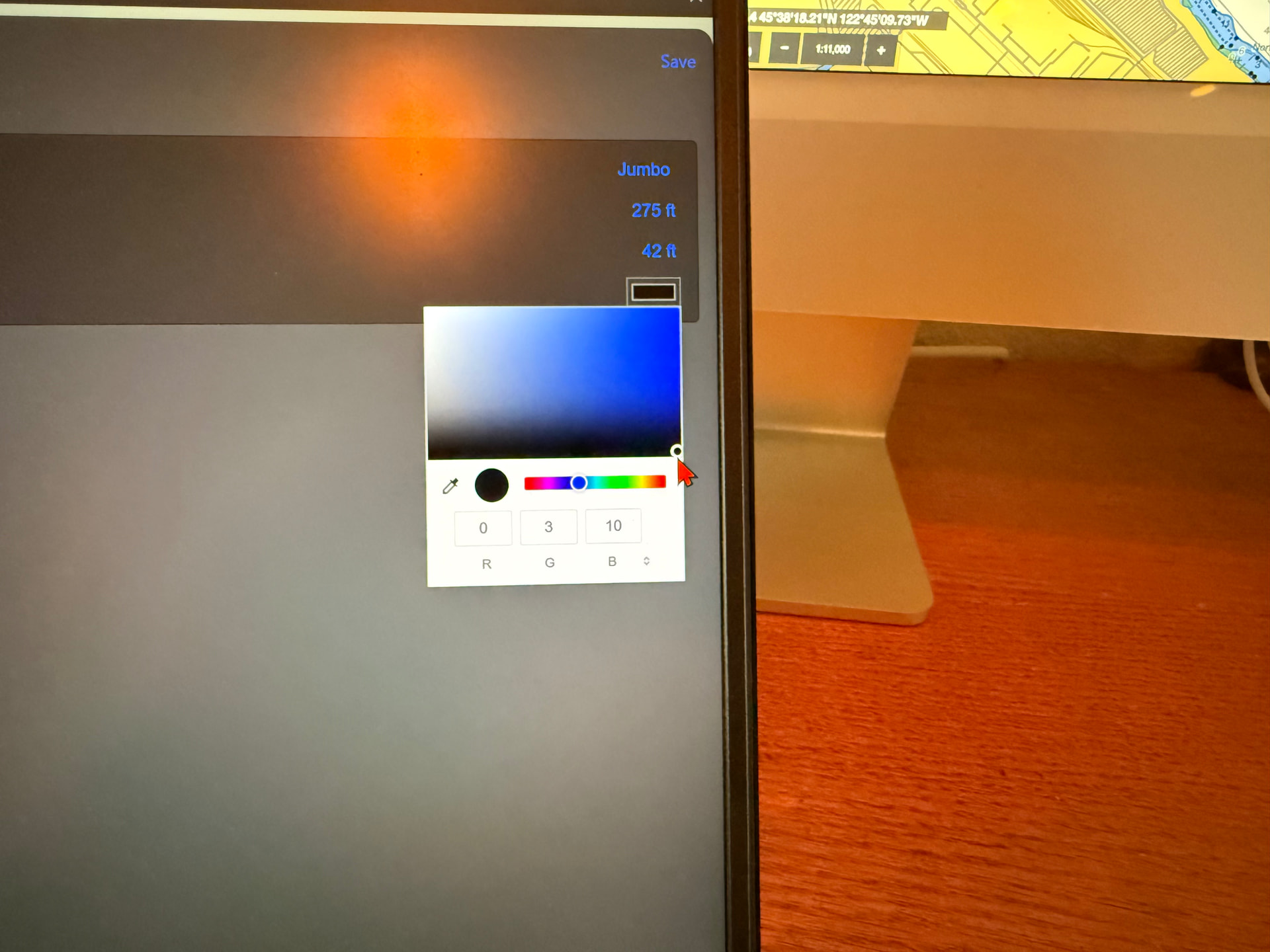

While building our barge fleet using black for high contrast between day dusk and night mode found that only one of the barge types would work in all 3 modes, not sure which exact black color I used in the one that works now but I’ve tried other colors on the slide and couldn’t get any others to work.:thinking:
I’ve always like building my tow using black so it would automatically change to white when changing to dusk or night mode.

Only pure black (0 0 0) will get changed to white (actually light gray) for dusk and night modes. Is that what you ran into?
That was it thanks, this might be worth pointing out in the final manual for other users IMO​:+1:
