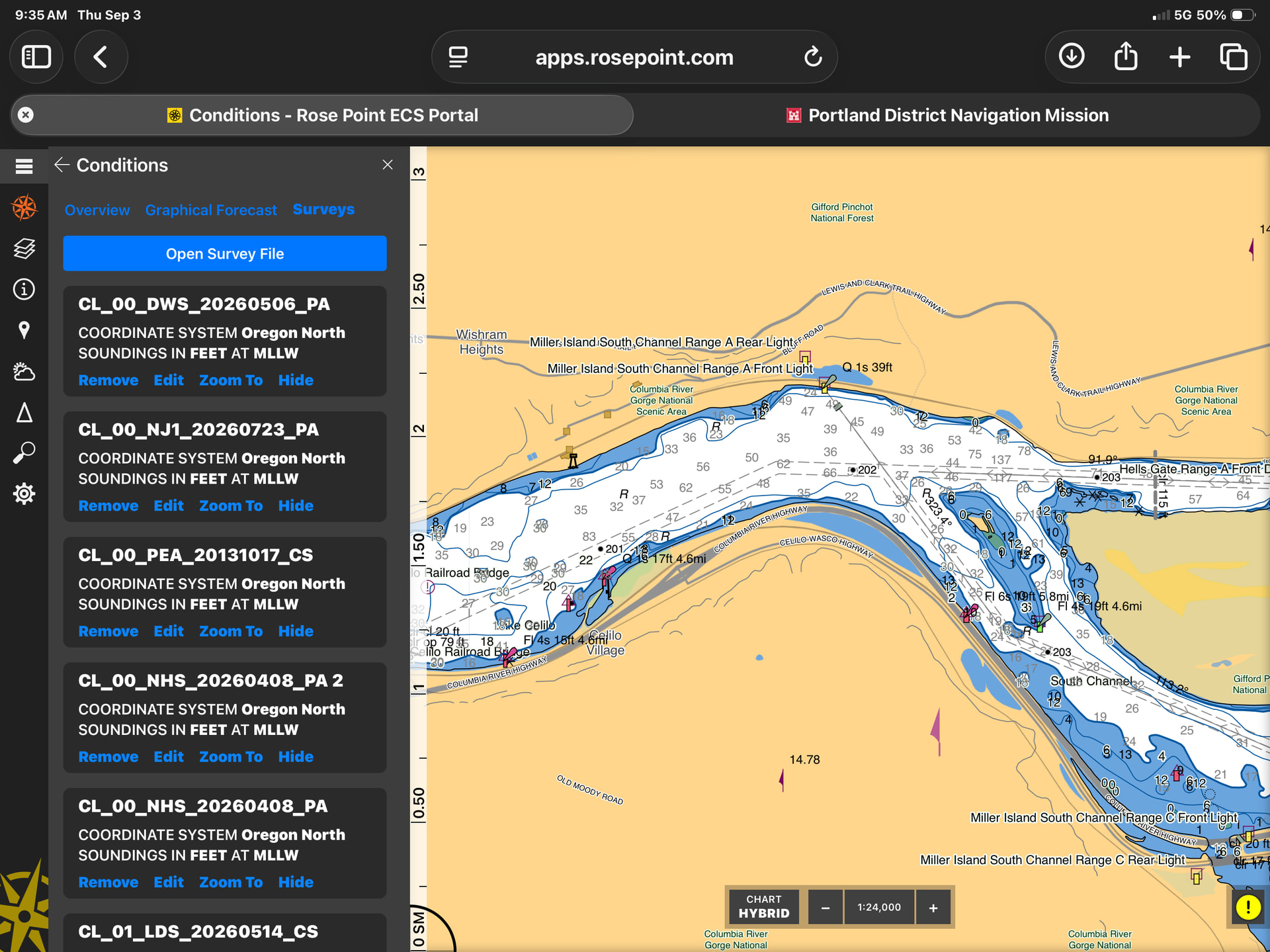

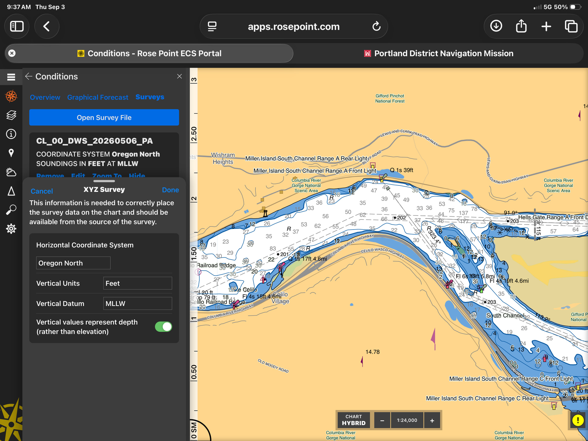

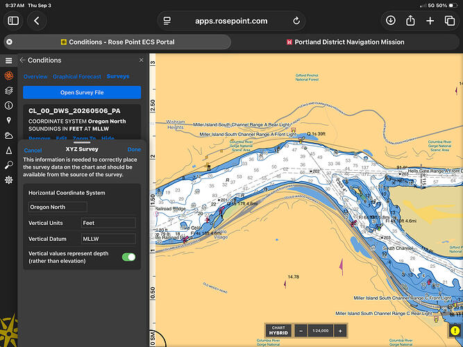

I’ve been playing with the XYZ files provided by USACE and find for the most part the user experience is not that bad, but of course when we close out Rose Point we have to do it again.
I know you are looking at a better way to get the surveys to Rose Point and was wondering if possible once the information is put into R.P. Could you make it where it doesn’t get lost when R.P. Is closed.
One thing that makes more work inputting the downloads is opening up and selecting the data field for the information and if possible it would be nice to only have to do that once while you are downloading the surveys.

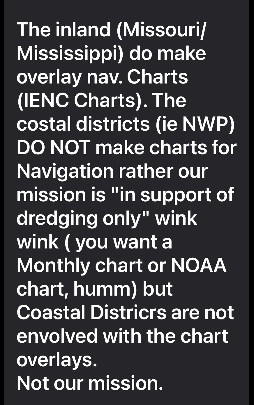

I like what I’m hearing but just had a chat with my contact at Portland district usace and he had this information that I thought I’d pass on for what it’s worth. He stress that is the IN land and not coastal USACE mission.
