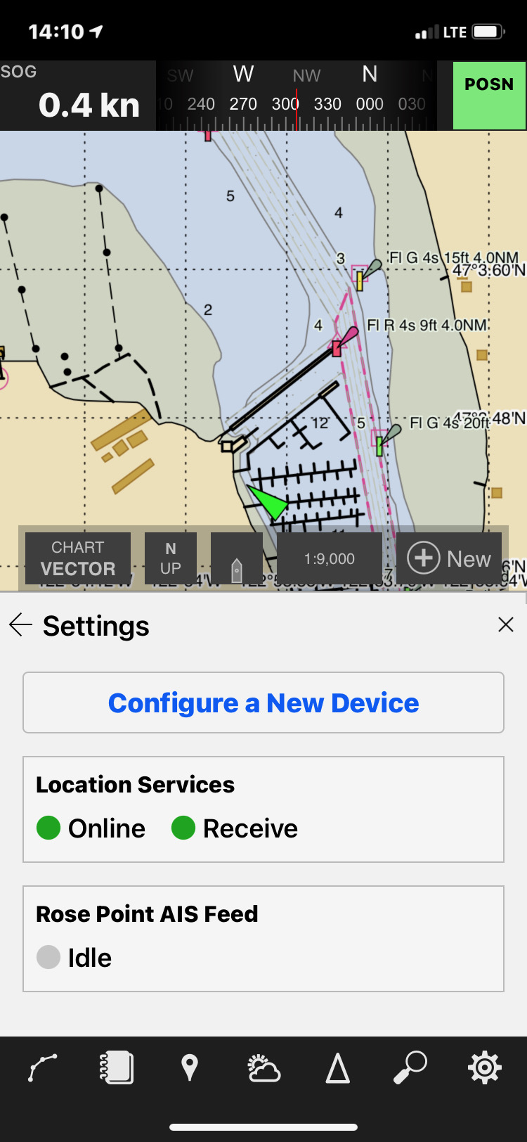

I entered the same IP address and port number in CE on both my iPhone and iPad. The iPad displays AIS targets but the iPhone does not.
The attached iPhone CE

Your screenshot does not show that the Vesper device has been configured for use on your iPhone. If it was configured, another box would appear along with Location Services and Rose Point AIS Feed and tapping that would show that port’s configuration page.
To get it working, tap the Configure a New Device button you see in your screen shot. Then select the type of port you want to use and enter the address/port information (this should all be the same as what you entered on on your iPad and PC).
