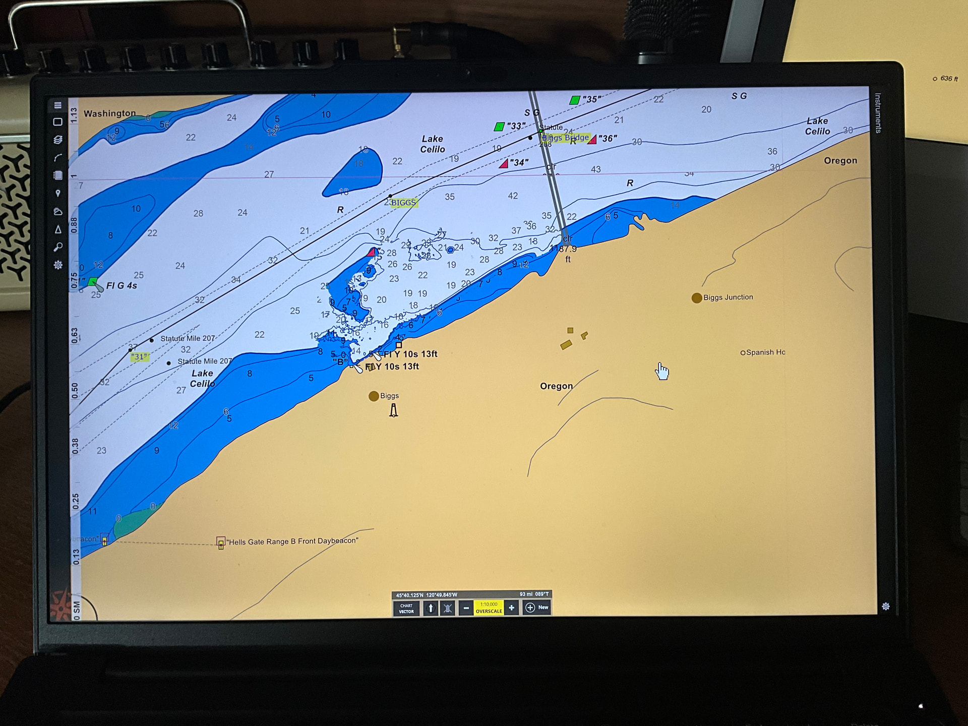

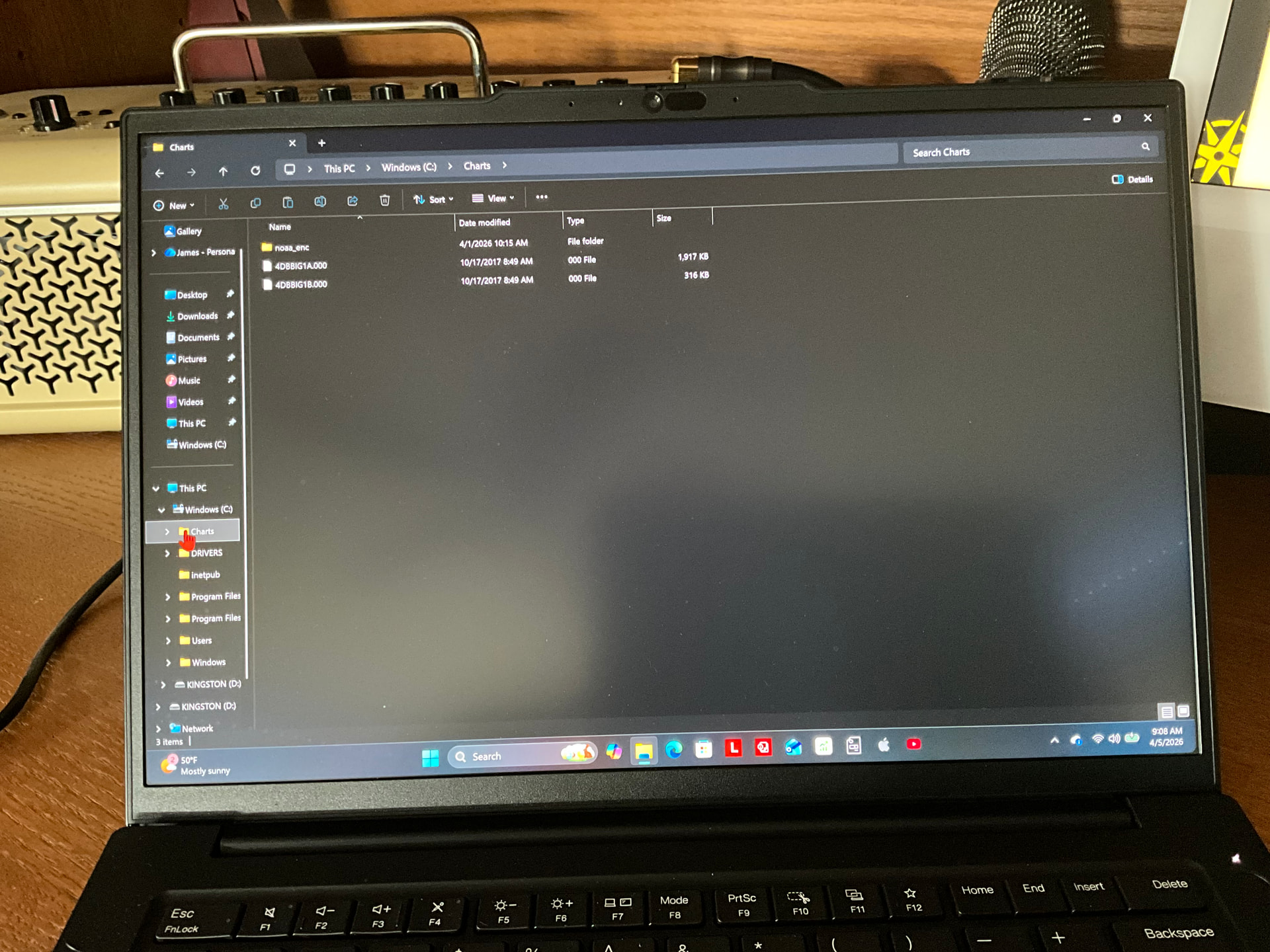

I have a company survey file that works with old version of ECS and CE but not with this beta test version. It’s in the charts folder on my hard drive and automatically loads it on the chart as long as my soundings are turned on. I’ve tried using the open survey file and going through the different settings but have not got it to work.:thinking: was wondering what I was missing in the update where it would automatically work if in the chart folder.
Those files are in the S-57 vector chart format that V4 could load directly but v4.5 cannot.

No, as I mentioned in a related topic, XYZ is a horrible format. But I’d like to better understand what is really going on here so see if we can come up with a good solution. Are you saying your company is doing their own surveys and producing these files? Is this an ongoing process (the files in your screen shot are pretty old)?
