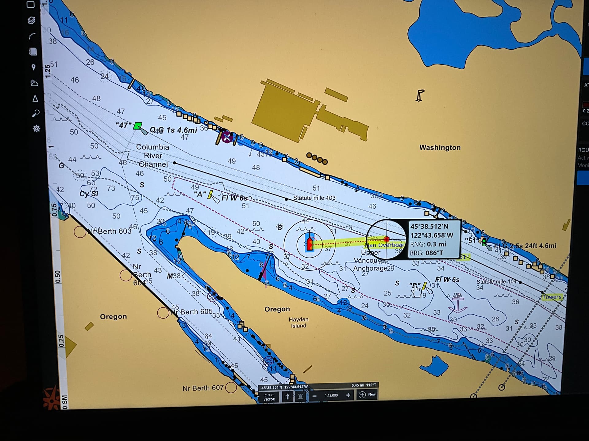

You may have already solved this, but for anyone who hasn’t, you can go to own-ship properties (right click on vessel > Properties) and make sure “Display line to Active Mark” is checked.
For what it’s worth I would consider using the Chart Loupe after dropping the MOB icon on the chart, that way you would get updated range and bearing info on the chart.
Bubba - is that Rosepoint ECS?
I’m a recreational boater, and use Coastal Explorer. I’ve not found anything like that Chart Loupe. Looks pretty handy.
It’s on the windows version CE and ECS. Usually parked in the lower left corner of the chart :+1: it looks like half circle when parked.
Found it! Very cool, had no idea that was there.
