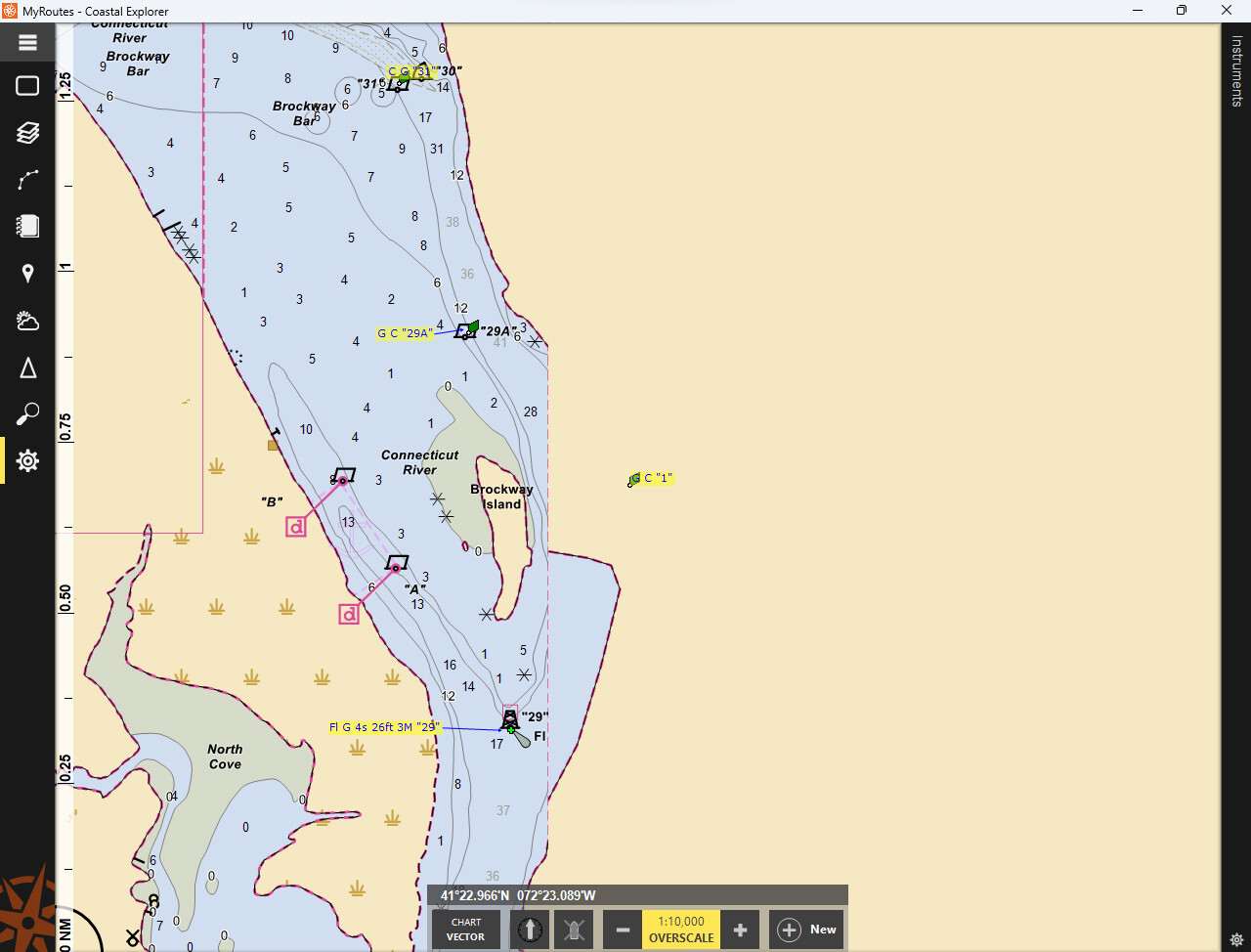

Hello! I can’t seem to be able to have vector charts show up for a few specific locations. For instance, on the Connecticut River, the old raster chart shows the entrance to Hamburg Cove in Lyme, Connecticut. However, when I switch to show vector charts, Hamburg Cove disappears and becomes solid land. Right-clicking in that area to show “Charts Here” only reveals two available vector charts, both of which are checked. I even unchecked one and then the other to see if that made a difference, which it didn’t.
Is there something I’m missing? I appreciate any assistance.
Nate
This might be better handled with a call to Rose Point Support, but have you used “Settings > Charts and Add-Ons > Store > NOAA Office of Coast Survey” to make sure you have all available charts installed for the regions where you are not seeing charts?
Hi, Brad, and thanks for the reply. You were right - not all the available charts were downloaded! I just did it now, and everything is fixed. I appreciate the reminder to look there first.
