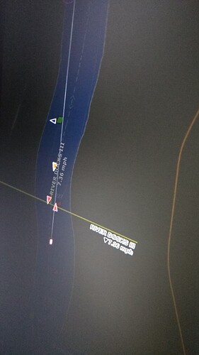

Vessel predictor/multiple targets showing up while passing
Whenever passing vessels it shows the vessel predictor target and cant figure out how to turn that off.
Looks like the show dead reckoned position is turned on in the AIS settings, if not possibly the show experimental AIS cpa location in Rose Point labs . Good luck :+1:
