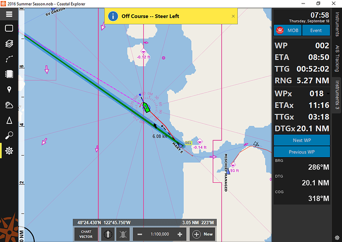

At least several of the mid-scale NOAA charts for northern Puget Sound and the San Juan Islands are failing to display. For example, US4WA31M is installed and updated, but when CE tries to display it, all it shows is the basemap. Unfortunately, 1:80,000 is a very useful scale for us, and it seems to happen with charts at this scale (Northern Puget Sound did the same thing as we were coming up behind Whidbey).
I tried removing the chart and having it re-download, but that did not solve the problem. Luckily, we still have paper charts to fill the gap. If there’s a fix though, would make our vacation easier.
